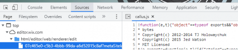

make sure you are using the following format for the website URL in 3CX:
https://xxxxxx-wixsite-com.filesusr.com
they use dashes. It will be different from the one I pasted.
Look in the inspector. It should be displayed as below:
See if that helps.
Thank you, David, but no it didn't help. Sorry :(
What did you mean by this, David?
if you right click in your browser, on the page you want the chat to be, you'll see a context menu appearing, select "inspect" (for Chrome, Brave) and then it will display a new panel with a bunch of stuff. Like so:
Great, thank you so very much, David. Yes, that was indeed the issue.
Anyone in the future should look there what David pointed to.
in my case the string was https://www-myfqdn-com.filesusr.com. That made ti chat icon come to life :)
