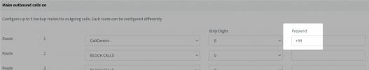

Alphabetic 3CX MVP Silver Partner Advanced Certified Joined Jul 1, 2016 Messages 6,688 Reaction score 2,671 May 13, 2022 #2 Check the E164 settings from the MGMT console. Alternatively, create an outbound rule to prepend the country code to local numbers.

JohnS_3CX Support Team Staff member 3CX Support Joined Jan 4, 2019 Messages 14,566 Reaction score 3,738 May 13, 2022 #3 It sounds like your provider requires the numbers in E164 format. Take a look at this thread, I think you will find it very useful for informational purposes: https://www.3cx.com/community/threads/what-does-e164-processing-actually-do.80829/ If the provider does indeed need it in E164 though, you will have to change your OutBound Rules to include it using Prepend. Maybe also strip the first digit. Last edited: May 13, 2022
