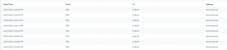

Recently I've been having a lot of calls from 'PBX' to 'EndCall' in my call logs. What exactly is this ?
See the attached screenshot
Thanks

Endcall is an option to "send" some calls to nowhere for a reason that someone chose. You'd have to do some more invesigation, using the 3CX Activity Logs for specifics on what type of calls these are. How they came into the PBX, where the original destination was, where it is set to end the call, and under what circumstances.
You may discover that there is a better, final route, to send them.
Exactly the explanation I needed ! Thanks !
