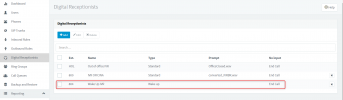

Hi @Kandima Call Admin in order to use the maid dial codes please validate in your system that the Wake UP IVR is already configured.
For example
Then try to use the maid code depending on what protocol is using your PMS (fidelio or mitel sx2000)
Please check the maid codes here
If you want to troubleshoot this further, then from the activity log, set the logging to Verbose and apply the changes.
Then restart the hotel service, replicate the event and then from the activity log --- click on logs --- check the hotelmodule.log

Hi @Alejandro_3CX, Thank you for taking the time to respond. The 3CX side configuration is fine. The phones that are not supported are working fine with the maid codes. The issue only arises with the recently introduced Fanvil H5 phones that were auto-provisioned. I will try enabling verbose debugging and check for any findings. I'll get back to you with the results.
