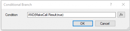

Thank you, I have build what you said, almost everything is working.
Only the part where if the call is picked up the callflow will Exit. This doesnt work yet. It will still follow the callflow.
Do I need to create a and Boolean with Variable + Constant Boolean = True
To get this to work?
CFD:
No, that's wrong. In the Loop you need to:
1) Make a call to a number.
2) Check the result
3) If the result is True, then exit, otherwise increment a counter or something, so in the next iteration you call a different number.
The Make Call should consider this counter, so it knows which number it has to call....
Reactions: nextcx
2) Check the result
@edossantos
Ok, I will change that part. This is the condition right to check if true?
Hi thank you,
I have built this loop:
2) Check the result
But still the callflow will not exit if external number picks up.
I have checked the 3CXCallFlow.log:
Callflow - OnMakeCallResult for component 'MakeCall' - Result: 'False
Looks like that the result from MakeCall is false, how can I fix this? Because the call is being answered.
I have fixed the issue, I did not create a outbound rule for + extension.
This post can be closed.
