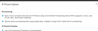

Firstly I think you're massively overthinking this as the DHCP 66 and RPS provisioning do the same thing.
You dont need to mess about with Yealinks RPS service as 3CX handles this directly with it
(Options button on phones page)
Security defaults from 3CX should be enough to secure your PBX. You could restrict your firewall to IP if you like (https://www.3cx.com/docs/manual/firewall-router-configuration/) but you'll probably encounted more problems then its worth.
if you're that bothered, fine a way to create a VPN between your site and the cloud but this would cause you to configure more routing.
