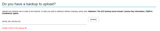

We are attempting to restore a backup from an existing self-hosted 3CX v20 Update 8 instance that uses a custom FQDN to a new 3CX-hosted deployment.
However, when we upload the backup file through the 3CX portal, the upload fails with an "Invalid FQDN" error.
Steps performed:
  • Created a full backup of the existing 3CX PBX.
  • Unlinked the existing FQDN from the 3CX portal.
  • Started the process of converting the system to a hosted deployment.
  • Attempted to upload the BACKUP.ZIP file during the restore process.
  • Received an "Invalid FQDN" error when uploading the backup.
Could you please clarify whether the xxxxxxxxDb.xml file within the backup needs to be modified to include a new FQDN and license key before the restore?
If so, what should be specified for the FQDN, considering that the system will be hosted by 3CX and we understand that a new FQDN will be assigned during the hosting process?
Any guidance on the correct migration procedure would be appreciated.

I have backed up the config via CMD - with FULL and without LIC,FQDN - the portal says it is invalid. And edited the Db.XML from within 7-Zip. with '0' and 'companyname.3cx.uk' same....
Can't start from scratch, as we have users preconfigured...
You can take the normal backup from gui and need to edit the xml within the container, dont unzip it. Change fqdn to the new one and change the key.

No, you need to release the old fqdn from the licence and install it with the new 3cx fqdn in the cloud. after that you can restore with the new fqdn from the old backup.

You need to migrate your licence to the cloud and choose a 3cx fqdn. This fqdn you can use to restore your backup afterwards

Can you take a backup without key and fqdn, release fqdn, "Install to hosted" then restore your backup? Or does the 3CX FQDN have to exist outside of hosted and then a backup/restore in to hosted?
Anyway..
If its the latter... I just did these steps to change my FQDN if it helps @DA Systems
- Backup 3CX via CMD without FQDN and Lic
- Release FQDN
- Reinstall 3CX and use the "Install" button from 3cx customer portal to deploy to self-hosted, run through setup to generate url
- Use URL to install blank 3CX with your new FQDN
- Upload your backup to your new 3CX (WinSCP)
- Make sure 3CX up to date then restore your backup
Then I guess take your full backup, migrate hosted?
switch to hosted... The fqdn will be chooses during the wizard.

This is where it fails over
1780486492307.png*
No. - It will ask you to choose your own FQDN - amazing, but now to update our configuration
Yes - the backup loaded then, (see below)

humour me, do this.
- Release FQDN
- Then take a full backup, trash this machine, go through setup of hosted install and restore this backup
