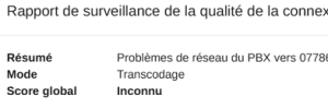

found it in another place :
i just made a test call. Score unknown.
ok : it seems that it was an audit extension enabled that expired. I now have data for MOS.
