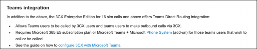

From this link:
https://www.3cx.com/docs/manual/microsoft-365-v18/
I see the following language:
The second bullet point states:
  • Requires Microsoft 365 E5 subscription plan or Microsoft Teams + Microsoft Phone System (add-on) for those teams users that wish to call or be called.
If we want our existing MS Teams users to be able use MS Teams for both INTERNAL and EXTERNAL calling - what MS365 license option do we need? The "or" in the above bullet point seems to imply you have a choice of:
1. MS 365 E5 OR
2. MS Teams + Microsoft Phone System.
Our current license level is MS365 E3 and obviously, the goal is to try to reduce any additional licensing costs from MS.
TIA!

The 3CX team's integration option is designed to use the team's app to provide the ability to make and take calls that are made and received through the 3cx system. It is, however, in no way related to internal calling using any team's call features. In fact, most teams' features, such as voicemail or call forwarding, need to be disabled to use the team's app with the 3CX.
What is required to integrate 3CX with teams is one of the mentioned 365 licenses plus the Microsoft Teams Phone standard license for each user that will be integrated. Or an E5 license, which has the Microsoft Teams Phone standard already included.

If you have an M365 E3 license for all your users already, then all you need is the Microsoft Teams Phone standard license (add-on) for each of them.
