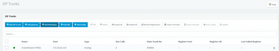

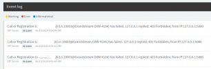

I am trying to set up a new installation using an HT841 gateway. I was able to get it registered with 3CX. I can receive incoming calls but am unable to make outbound calls I continue to to get SIP: replied: Busy Here (486) in the event log. When calling out, I receive an audible 3CX message saying “the number you are trying to reach is busy, please try again later”. Unconditional Call Forward to VoIP is for routing inbound. How do I configure the Unconditional Call Forward to PSTN. I am assuming this is for outbound but I have tried numerous variations and nothing works. Anyone’s insight would be greatly appreciated.
