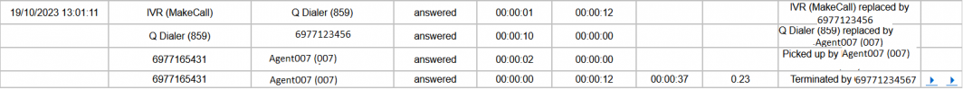

I have attached a print screen. You are right about the flow. But I want to ask when the dialer (IVR (MakeCall)) initiates a call? If it initiates a call when an agent (that is logged in to the queue) is free then οκ. Although from what I see there is again a 2 second silence before the agent responds (automatically) which is the same as before
The dialer flow is executed in a loop, pausing the execution a few seconds between each iteration. This is not triggered immediately when the agent gets free, the dialer doesn't work with notification for such events. It will just poll for free agents in the next iteration.
