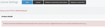

I previously had a partner ID, but today I restored a VM from a Veeam backup and need to add the partner ID. How can I obtain the partner ID? I urgently need this for further updates.

Everything was fine yesterday. The server crashed, and I restored it, and then this problem arose ))
Did you upgrade to v20 then restore a v18 server? The license key is "upgraded" so you're not supposed to/allowed to go backwards. If this is the case you should be able to install 20 and restore your backup during the install.
