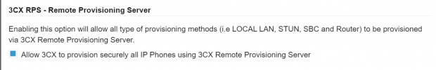

Also note that V20 has the option to switch off 3CX RPS usage completely:
Alright, that might be what I'm looking for! I'll look into this.
With V20 it's possible to use your own RPS to provision a router phone :cool:
