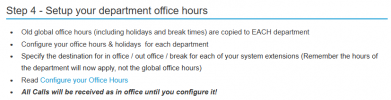

https://www.3cx.com/blog/releases/v20-upgrade-checklist-faq/
"Old global office hours (including holidays and break times) are copied to EACH department
Configure your office hours & holidays for each department"
Any configured Global hours will be copied over to each of the departments, if you didn't configure the office hours under the departments from the Version 18 Admin Console.
