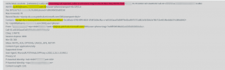

@NickD_3CX
below is a screengrab of one of the errors... it's saying call rejected caller unknown?

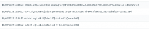

if i close down my teams and call the queue on it's extension using 3cx webclient i also see a number of these:

The INVITE message with the caller unknown is an incoming request FROM teams, to 3CX. the Agents not ringing though has something to do with 3CX SENDING to the client.
