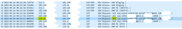

I have set up a PBX with two SIP trunks which will eventually be used for two different companies working out of the same building. All has been going smoothly up until recently when it was noticed that all outbound calls are routing through the second SIP trunk, my investigation found that the first SIP trunk is sending a BYE:

I have already been in contact with our SIP provider, it was they who advised the PBX is sending the BYE and provided the 1st log above.

The capture from your provider and the screenshot from the PBX so not seem to corelate as its a different error received in 3CX. You could make your own capture right from the PBX and see if you get any errors there in addition to the activity log.

WireShark shows SIP trunk 1 is rejecting the INVITE (403 Forbidden), the call re-routes through the second SIP trunk and completes without issue. I'm currently reviewing the dump.pcap file capture to try to determine why this might be happening.

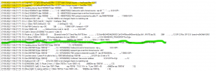

Hi @YiannisH_3CX I have included an excerpt from the bin log file where it shows the PBX attempting to use line 1 (line: 10000 in the log) and then switch (highlighted in green) to using line 2 (line: 10001). I am not seeing any errors recorded though.
IP addresses and phone numbers have been redacted.
Without the full logs, the PBX configuration and a packet capture I cannot tell you why this happens. That is why I suggested contacting our support department.
