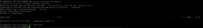

Having just recently installed a new debian 3cx v. 18u2 on HyperV at a client site I'm experiencing som problems activating the license.
We keep seeing "license_error.HTTP/1.1 400 Bad Request"

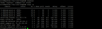

I cannot seem to find any logs on the server and I've verifiied correct internet access (using curl). I do not control the firewall so I'm wondering if there's any tests I can perform using cURL or log files to read which may help me solve this issue.
Btw. the server updates just fine - just installed U2 today, but the problem persists.
Logs from /var/lib/3cxpbx/Data/Logs/PbxWebConfigTool.log
/mikkel
