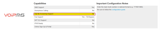

Voip.MS does not support clip no screening, it means you can use as outbound caller id the numbers in your account, you can not send any number as caller id.
If by chance they allowed this to you, then you need to edit the sip trunk template in order to user the parameter originatorcallerid in the SIP Field used for the outbound caller id, normally the from user part.

- Thank you for clarify - that VoipMS will not do this. I think

You can check the list of supported voip providers here and validate the support for clip no screening
