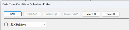

4) Replace everywhere:
IsServerInHoliday(myCall)
with:
officeHoursManager.IsHoliday()

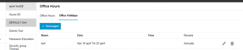

With these changes to the C# code, the CFD app should work according to the following:
- When the CFD app is "system wide", it should follow the office hours for the "default" departament.
- When the CFD app is assigned to a departament, it should follow the office hours of that department.
