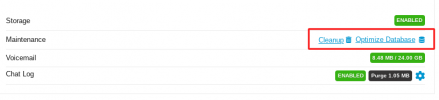

@Muhamed Ibrahim, I just ran a sample report from my demo system, and all worked as expected. Can you confirm that your server is properly spec'd for the size of installation you have? Please refer to our website for Hardware Requirements. Underspec'd machines are often the cause of this type of issue.
Additionally, you may want to clean up your database and optimize it for better performance. This is located on the Dashboard within the Admin Console.
