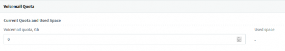

Voicemail quota: Management Console >> Settings >> Voicemail
Make sure both have not been exhausted.
I upped both but neither has had any effect

In the screenshots you provided, the "Used Space" for both the Recordings and the Voicemail is not detected. Have any changes been made to the drive either physically or on the OS level? If a Linux machine, can you confirm whether the file permissions are in order for these two directories? The user phonesystem must have read/right/execute permissions on these directories.
