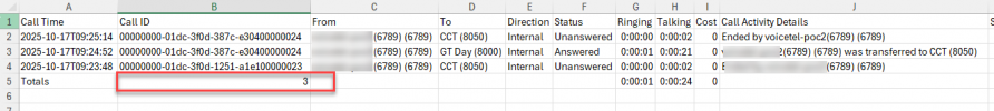

Hi 3CX Support,
Ok abandon call report is ok.Let see this call report, this sample today has 2 calls but total is 3 calls.
Each leg of the call is listed separately - one call was transferred. There are specific reports that separate out just the incoming leg.
Also for reports, going to Update 7 will bring in several fixes, you can see the Blog posts and Change Log for details.
thank you for reply,
This is report call log from V20 update 7 built 1057
- Abandon call report can fix already, but call report not clear this problem. I think total of report is number of call process, not total row in report.
Thank you.
I believe I understand your logic, but then there is the other view that each call leg should be counted, as internal forwards etc do initiate new calls. If the system is 16SC+, you can always use the Data Export to easily build reports that reflect each customers specific needs exactly.
