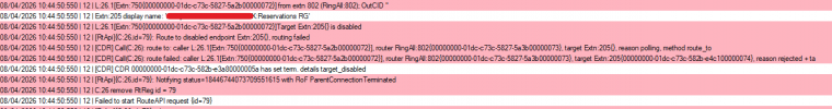

Just an update on this...
I ended up using Bin Log Viewer.
And whilst Im absolutely not good at using this tool, I did find the following record:
This pointed me in the direction of extension 205 which is disabled from 365 sync.
Removing this disabled extension allows the RG to go to the voicemail box of the RG.
Surely this cant be design? This would be a PITA if this was a big install and 205 was in multiple RGs.
I then changed the DNA routing to a users VM, another RG, external number and the outcome is the same with this disabled extension in the RG.
Additional question:
The BLV showed me the polling of each extension, but at which point in the logs where it fails does it indicate to me why?
As far as I can see, this is the "end" of the call - is this line telling me that the cancellation reason is because of 206?
