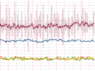

it's not google's connectivity, it's the docsis node or neighborhood the customer is in. I have other customers as close to across the street without these problems.
graph below is the site in question (red) and the jitter (shaded red) and other sites nearby. The blue one is across the street and down 1 block. The other 3 are just a few blocks away. It's this specific site.
And yes, while this is primarily a connectivity issue, TCP erases that issue.
