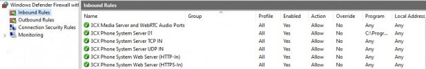

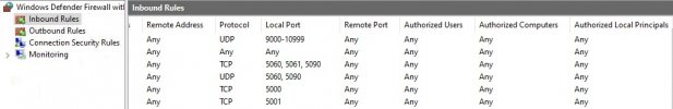

I just upgraded the 3CX server running on W10 from v16.x to v18.0.234. Now I have the next problem: all my SBC connections are down. In one location, I uninstalled the old SBC v16 and installed the new SBC v18, but no success.
I suspect that the tunnel do not bring up.
All services are runing fine. The firewall check is ok, including port 5090. I use ports 5060 for SIP and 5090 for tunnel. Any idea, please?

I did a fresh install and nou it's ok again. I did a mistake installing the 3CX PBX v18, regarding the FQDN, at the step where is asking to use FQDN or IP. Previously, I selected "No, I do not have a DNS server and will use a local IP". This time, I selected "Yes, I have a DNS server and will configure a single FQDN that works both in and out of the office".
I was confused by the first option.

I selected this option for the first time, and the tunnel didn't work on port 5090 (no service for tunnel started on PBX to listen to port 5090), affecting the connection of SBSs and mobile phones. The second time I selected the other option and everything is fine.
