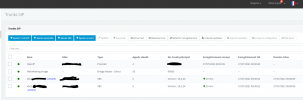

Hi Nick,
Thanks for that news, Have tried to update 2 SBCs from a V18 Beta 1 PBX but it seems update button apply no change version on SBCs.
Have waited almost 10 minutes and refreshed console view with no result. Release stay the same 16.2.24
Am I missing something ?

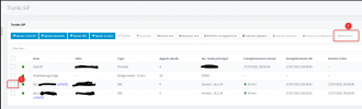

I'm going to say this just in case, please excuse me if it's self-explanatory, but to upgrade the SBC via the Management Console, you need to:
  1. Select the SBC entry in "SIP Trunks"
  2. Press the "Update" button.
NOT press on the blue "[Update]" text below the entry.
that's what i did ;)
