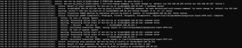

The output of grep /var/ came back with loads of errors in the pacemaker service log, here's a snippet of the error:

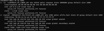

in the last screencap we get a no such device error on what I am guessing is enp1s0, when we look at "ip addr" what devices are listed?
Here's the output
It's definitely showing both the IP for SBC1 (222) and the floating IP (224) on enp1s0
I am out of ideas, if this is classified as a test environment I would just change the ips, maybe test the other sbc, let us know what happens.
