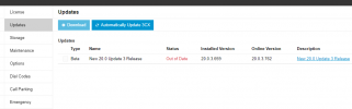

We are on Version 20.0 Update 3 (Build 659 Alpha). The updates page on our system is offering: 20.0.3.762
