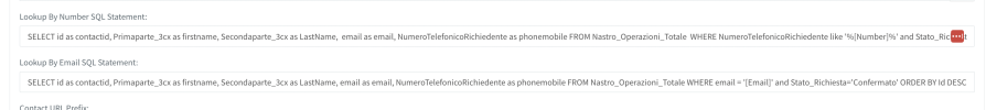

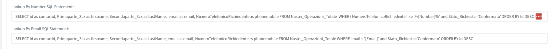

I report a bug when generating contacts on 3cx address book.
If I overwrite the database or delete all the contacts in the database having set me to always check the sql database, the 3cx system creates another contact, it does not overwrite the previous one even though the same number and email is used.
In order to use the same contact, you need to return the same Contact ID. The email or phone number are not considered a "primary key" for this.

For the second point, I created another database called contacts, check, create and update the name, keeping the same starting id.
I solved :-)
