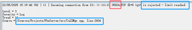

Does anybody meet with the issue like this?

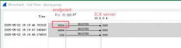

When one endpoint manually registers remotely to the 3CX server, after the endpoint sends the registration request to the 3CX server, we make a capture at the 3CX server and find that the 3CX does not send any reply.
And in the 3CX log viewer, at the same time and on the same port, we see a related error message, but we can't recognize the error, can anyone help us check it?

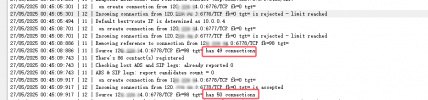

Thank you for the reminder. We checked the 3CX detailed logs again and found many connections from this public IP. May I ask what the default limit is? Can we modify this value in 3CX server?
The endpoint has been continuously initiating registration requests at roughly several second intervals, regardless of whether or not it succeeds in registering.
