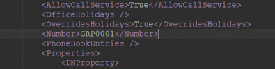

Actually, there's something you could do to identify the ID to which you would need to transfer the call for this:
1) Make a backup of your 3CX installation.
2) Unzip the file, and open the XML containing the configuration.
3) Search for the <Group> element, for example here I have a group named "Group1", and looks like this:
4) Scroll down until you find the <Number> element for this group, for example in my case:
5) This means that my extension group is identified with the ID GRP0001. Then, from a CFD app, I can transfer the call to that ID, as follows:
