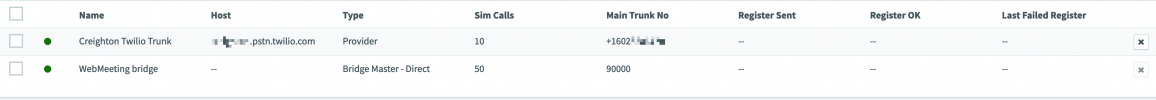

Thanks Joel, it looks like I'm fully authenticated, as I have 2 trunks here and they both show I'm up on the dashboard (BTW, yes, followed the elastic trunking guide).
Maybe you can tell me, should I show registration data on the trunk display? Does this look like a successfully setup trunk to you?
I do receive inbound, and can navigate the IVR, just can't get successful outbound. But as of this moment, it has stopped throwing the Twilio caller id messages, so I have minimal information to go on. I have a dashboard trunk warning that this is an unsupported trunk. See below.
Hi @Creighton
For the dashboard to show your trunk as unsupported it means that you either used a generic template to add the trunk or you used the import button. You show as supported you need to use the template that is included in the PBX.
Twilio trunks will always appear as registered as they are IP based trunks and there is no registration involved.
So make sure you are using the correct template to add Twilio and make sure that you have added the correct public IP in Twilio.
You also need to add the correct credentials (auth id and password) in your trunk settings. These are used for outbound calls only.
