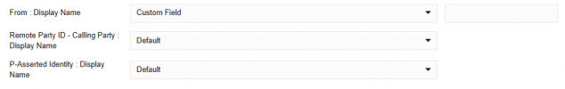

Since updating to version 20, Caller ID Name is no longer displayed in 3CX. It was working with version 18 prior to the upgrade. This is for ALL 3CX servers I manage.
I can confirm that the information is being passed on from Twilio in the 3CX pcap logs.
I assume the changes need to be made here, but no matter what I change, I still get no Caller ID Name.
