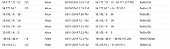

I have placed all the Twillio IP Addresses in Whitelist

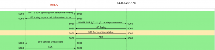

Twillio Support have said they are getting a 503 error

Check that all your services are started. You can do so from the Dashboard / Services. If something is not started then try to start it manually. 503 service unavailable usually means that some component is not working.
