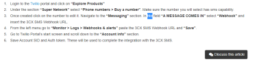

As someone only using SMS with Twillio, and not the SIP trunk, this article is not clear on how to configure that scenario, and migrate from using just SMS with the old messaging interface.
As Twilio is an IP based provider, you can just set up a dummy trunk and set your SMS there.
Perfect, I tried and failed. But I will give it another go.
Recommend a note added to the manual.
Reactions: YiannisH_3CX
The last line of the instructions is:
Save Account SID and Auth token. These will be used to complete the integration with the 3CX SMS.
But then there's nothing else. It doesn't tell you how to use the Account SID and Auth token to complete the integration.
I'm also not seeing any messages arrive in 3CX when I send them into Twilio after following the setup instructions. Any clues about how to debug the issue? I can see the messages in the Twilio logs, but they're not showing up in 3CX.
