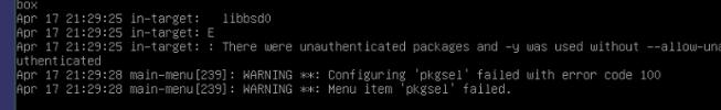

Trying to install 3CX on my Hyper V host, but I get an error message part way through the installer:
"An installation step failed. You can try to run the failing item again from the menu , or skip it and choose something else. The failing step is: Select and install software."
I went through the syslog and found the following error:
" WARINING ** Configuring 'pkgsel' failed with error code 100.
"WARNING ** Menu item 'pkgsel' failed. "
Any advice on how I can proceed with this install and get it going?

does the vm have internet access?
I am able to ping across the internet, so there should be no issue with internet access. I've noticed that it fails at 10% every time. Tried with a freshly downloaded ISO and an older ISO file that I found on one of my servers.
Hi @AdamAK,
- How much disk space are you allocating to your VM?
- How much RAM have you allocated?
- How many CPUs have you allocated to the machine?
I get this problem when I misconfigure the network. Check your DNS is set to Google also.
Hey guys,
Turns out it was my firewall. Our HTTP proxy was blocking some part of the install process.
Thanks for all the help guys.
Reactions: VasilisV_3CX
Great to hear you managed to figure it out @AdamAK, if you need any further assistance feel free to create a new thread.
