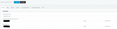

Once you have the static route set, you will need to configure the trunk as a generic trunk in 3CX, using the Supplied SIP signalling IP from Optus
Authentication is not required/IP Based
Set your main trunk number. Optus uses standard 10 digit format ie 0X XXXX XXXX
