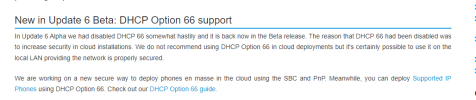

Following the deployment of Update 6 one major change we saw was the provisioning URL changed from a fixed to a random url for each phone. This is causing lots of issues with DHCP whereby we need to get the right provisioning URL for each MAC address.
Is there a way to get the correct URL for specific MAC address via an API?
In all previous version the provisioning URL used to be a fixed one and this eased the deployment of DHCP and Config.
Any suggestions would be most welcome.
Beta version released this week has this back
https://www.3cx.com/blog/releases/v18-update-6-beta/
