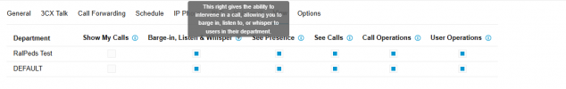

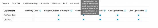

Also FYI the Info Tip for "See Presence" and "Barge-in,Listen,& Whisper" both list the same information:
