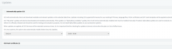

I am also unable to see an Upgrade function in the system.
Can I have some help with this?
The system doesn't allow me to update to a new Version, I need to get this setup as soon as possible.
@GregG_3CX
That guide says to Upgrade the version through the "Updates" option.
There is no option too in the Updates menu.

@Hackett - If your old license has expired, you will need to renew it first. Then you should have the option to upgrade to v20.
