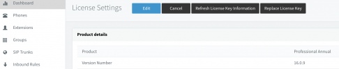

From the 3CX License Settings (Restored from a previous backup)
Version Number16.0.9

Weird no?

I just checked - I used this ISO debian-10.5.0-amd64-netinst-3cx Instead of the Beta 2 version. Would that be the problem?
Anyway, I will re-initiate the ISO install (now the BETA2) and update you.
Yes, that would explain it! That ISO was for a tech demo back in July of 2020 we released for 3CX v16 on Debian 10. The specific configuration scenario was never officially supported as we opted for a new major release (3CX v18) along with the transition to a newer Debian version (Debian 10).
Ok. Just weird that the update wasn't presented no? Lets see. I am installing.
The update was not presented due to the fact that it targets supported configurations meaning a combination of Debian 9 + 3CX v16. Another reason is that the update does not only upgrade 3CX v16 to v18 , but it actually also upgrades the OS from Debian 9 to Debian 10.
