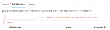

Just put a * in front of your local number. Instead of +6112345678 put *5678
tried that and this is what I still get - So not an option as far as I could see

Still shows (Adding a "*" is not allowed, please provide the full number)
when I type an * into and of the trunks DID fields
