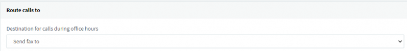

you just put the DID on the Fax Server setting and put the email address you want it to go to.
In V18 there was option on inbound rules to for Send fax to and there was option to select extension number - and as result it was allowing to have option to assign email address on this extension and send this fax as email to specified email address on extension (a multi fax server option to allow fax to email for different email recipients).
I don't see this option in V20 - most likely customers will stay on v18 or look for other PBX solution.
