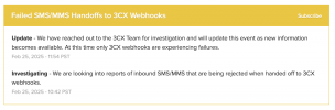

Flowroute messaging did not work at all yesterday and is still not working this morning on my system. Messages are definitely being received by Flowroute as they are in the logs but not 3cx. I am able to send SMS only, not MMS.
The Flowroute status page says it's a 3cx issue. Please advise.
Flowroute did contact us regarding this and gave us a few examples. The issue is happening to multiple 3CX versions which have been released for months and no changes were made to those.
SMS is handled locally on the PBX and since we have multiple versions of the PBX affected which have been working for months and no changes were made to those, then the issue is not from 3CX. We suspect something changed on Flowroutes end but we are still investigating.
