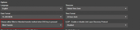

seems that blind transfer is working, but the second I choose to transfer by default the key chosen is Attended transfer, now the user need to press blind transfer to be able to transfer the call (was working fine on V18, now it is not on V20)
please advise
What is the selected option in the phone provisioning tab?
Can you please re-assign the BLF key?
so I trick the system, I think i found a solution
on the grandstream - settings - Call Features - I changed: Attended Transfer Mode from Dynamic to Static
and on the Transfer Mode via VPK/MPK I setup: Blind transfer
I tested it in my home and changed all the phones remotely hopping tomorrow all will work

When you configure a phone to the user you have the choice of selecting Blind or Attended transfer through the template

Attended transfer doesn't work only blind transfer
transfer to BLF work only if Attended transfer disable on the phones and the provisioning with 3cx disable
