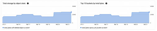

As far as buckets, it does not appear that operation was ever interrupted - the outage was halfway through March 20 and ended early March 21. This is not my expertise, however, so if you can walk me through getting you a better report I'm happy to do it.
As you know the transcription will take place once the recording/voicemail is uploaded to the Google service, in your case the bucket. So in the event the recording can't get uploaded there, it will re-try. Now, it can also be the case if Google service itself does do what it is supposed (no perfect system out there).
If you had your Hosted instance logging in verbose, and if there were any errors, you could look in the system service log (after you generate the support info file you will find them there), but if not errors, and the recording is uploaded to the bucket (it will be marked with an archived icon under the recording then) then maybe its something with the actual Google service and they could advise.

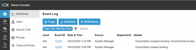

In V20 we've added informational event 16384 which is recorded whenever transcription status changes.
When transcription stops working, one can check the Event Log for this event which would contain the reason of failure (see attached screenshot). This might provide some insight on the cause even without checking the logs.
On a busy system with many events one better input "16384" into the "Search" field to quickly find these events only.
Hey, Ivan. So 16384 is not triggering. What *is* triggering is 30052 - for some reason I have exactly one mobile number that is absolutely infuriating 3CX.
