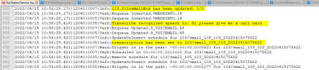

Now for the logs, you will find entries mainly in the "3cxSystemService.log" file, but also a few at the same time stamp in the "3CXConfService.XXXX-XX-XX.XXXXXX.log" file, but it should look something like this if it works:
