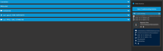

If you dont get any error and you can join the meeting but present connectivity issues you could enable the troubleshooting as the pics below:
When you end the meeting a file with the telemetry data will be downloaded.
Then click on troubleshooting analyzer
Then you can check the connectivity for those users who were presenting the failures, etc
We ran the test and during the test did not face the issue and troubleshooting result shows nothing. We should probable do this for all out meetings going forward to collect the data.
