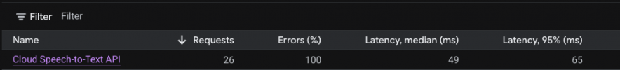

After upgrading to version 20 our voicemails are not being transcribed anymore.
I setup the Google cloud storage as a separate project from our GCP and enabled the API.
I do receive the email with voicemail attached.
I do see the API hit in Google console with 100% error rate (see attached)
Does the Google cloud storage need to be in the same project as our server?
Any help is appreciated, I am not sure how to dig into the API error in Google cloud.
Google Cloud Storage setup guide needs an update.
https://www.3cx.com/docs/google-cloud-storage/
Section:
Creating a Service Account
Step 5
Service account created for storage also needs Cloud Speech Client permission if being used for speech to text transcription. Without the additional permission you will see "Permission 'speech.recognizers.recognize' denied on resource (or it may not exist)." in the logs.
