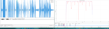

    Incoming calls are having choppy audio on callee end. Calls internally and outbound calls are fine. We have Pcaps to provide insight on the issues and are looking for assistance on where we can pinpoint and resolve the problem. Thanks in advance.

All users are at the same location. We had people working remotely using the 3cx phone app also experiencing the issues. It appears to be from the PBX to the carrier from our investigation. Our pstn shows no call drops in their Pcap. However our pbx capture to our pstn shows RTP packets dropping.
Same issue from Monday last week with 3 of our pbx hosted on 3CX (DigitalOcean). We contacted with the Hosting team and they told us that there was no connectivity issue on their end. Our voip provider provided us with another sip server on diferent location and issue was mitigated. (Spanish voip provider)
Got same traces as yours, RTP traffic captures show how packets are being lost always on same way. Sip server -> hosting Ip.

We were able to upgrade to this lastest version of host 3cx and are still having the same issueScreenshot 2022-07-12 115802.png
